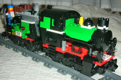

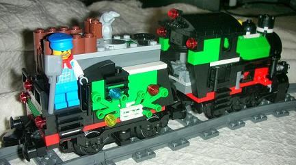

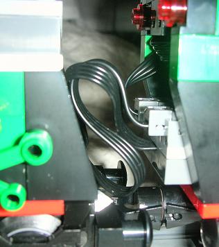

jamzee Posted November 29, 2011 Author Posted November 29, 2011 Thanks everyone for your ideas. Last year I put the motor as the first set of wheels in the passenger carriage but this year I'm determined to contain everything in the engine or tender. I'm pleased to say I've just managed it - the receiver is in the cab of the train and the motor is powering the tender with a set of those nice 'wheel covers' to make it blend in. I've had to modify slightly the back of the tender to accomodate but am pleased it is all self contained. Also, the lights follow the tank of the engine from the lamps at the front (raised slightly on a 1x1 round tile each side) and disappear unseen into the cab under a 2x1 inverted black slope each side. I can now add the passenger carriage to my Emerald Night now and again as it is completely independent!! Quote

jamzee Posted December 1, 2011 Author Posted December 1, 2011 (edited) Pics or it didn't happen... This is the internet after-all! Here it is! This is all self-contained and MOC'd using only the parts of the original tender... it did take quite a while to sort. Enjoy! Edited December 1, 2011 by jamzee Quote
