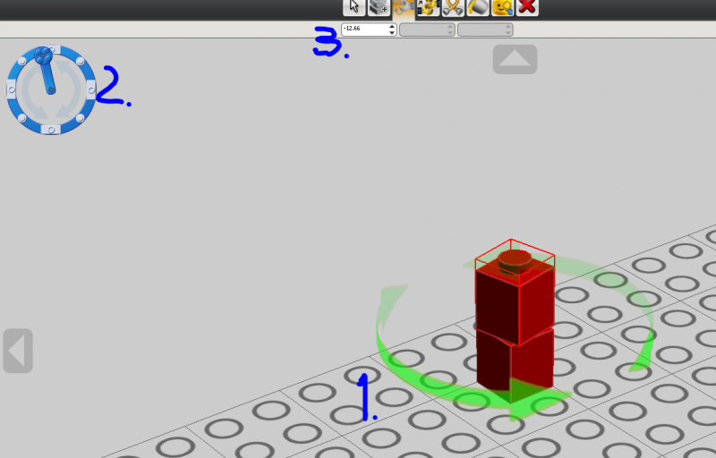

ma05860 Posted June 8, 2013 Posted June 8, 2013 Hello to everyone . I'm new here and i'm very happy to be a member of this community . I have a question .How can i ortate bricks to ldd in any angle i want to ? Thank you for your time!! Quote
Classicsmiley Posted June 8, 2013 Posted June 8, 2013 Hello to everyone . I'm new here and i'm very happy to be a member of this community . I have a question .How can i ortate bricks to ldd in any angle i want to ? Thank you for your time!! Have you experimented with the hinge tool yet? Quote
Calabar Posted June 9, 2013 Posted June 9, 2013 "Fine" rotation need a pivot, which consists in a connection with another brick. Once the connection is stated, you can use the rotation tool to rotate the brick at the angle you desire. Quote
ma05860 Posted June 13, 2013 Author Posted June 13, 2013 Thank u very much . Its a little complicated but very helpful. Quote
Calabar Posted June 13, 2013 Posted June 13, 2013 Agree with you, not much comfortable: a free rotation, for example using a R + mouse, would be very appreciated. Quote
Superkalle Posted June 13, 2013 Posted June 13, 2013 I'm not sure I follow guys. How do you mean complicated. I think it's pretty straight forward. You select a brick to rotate and have three choices 1) click on the green arrows in the model (good for simple rotation, or rotation a brick to a "stop" against another brick) 2) click on the rotate wheel (perfect for 45 or 90 degree rotations) 3) you enter a free value.(perfect for fine tuning) Quote
