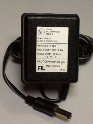

DLuders Posted November 23, 2011 Posted November 23, 2011 @ le60head: This Bricklink inventory of the 8485 Control Center II set shows two different transformers; pick the one to match your country: 70931 "Black Electric, Train Speed Regulator 9V Power Adaptor 120V 60Hz": 70928b "Electric, Train Speed Regulator 9V Power Adaptor 240V (UK)": Quote
Blakbird Posted November 23, 2011 Posted November 23, 2011 @ le60head: This Bricklink inventory of the 8485 Control Center II set shows two different transformers; pick the one to match your country: 70931 "Black Electric, Train Speed Regulator 9V Power Adaptor 120V 60Hz": 70928b "Electric, Train Speed Regulator 9V Power Adaptor 240V (UK)": Don't feel constrained to those transformers. You can use any 9-12V transformer with your Control Center II. I have tested dozens of different models. For maximum current through 3 motors, choose one with at least 1000mA. Picking a larger one doesn't hurt anything. The Control Center will only pull as much current as it can use. Quote
