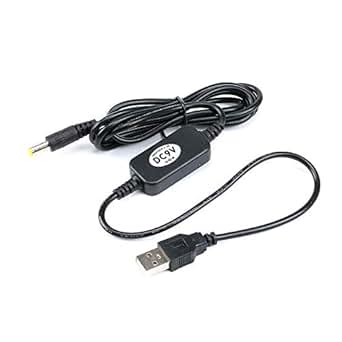

Dummy AA battery adapter and a USB to 9V booster.
Dummy battery adapter can be made yourself.  USB to 9V boosters can be found at your local electronic shop or on Amazon, Ebay, AliExpress, etc.
