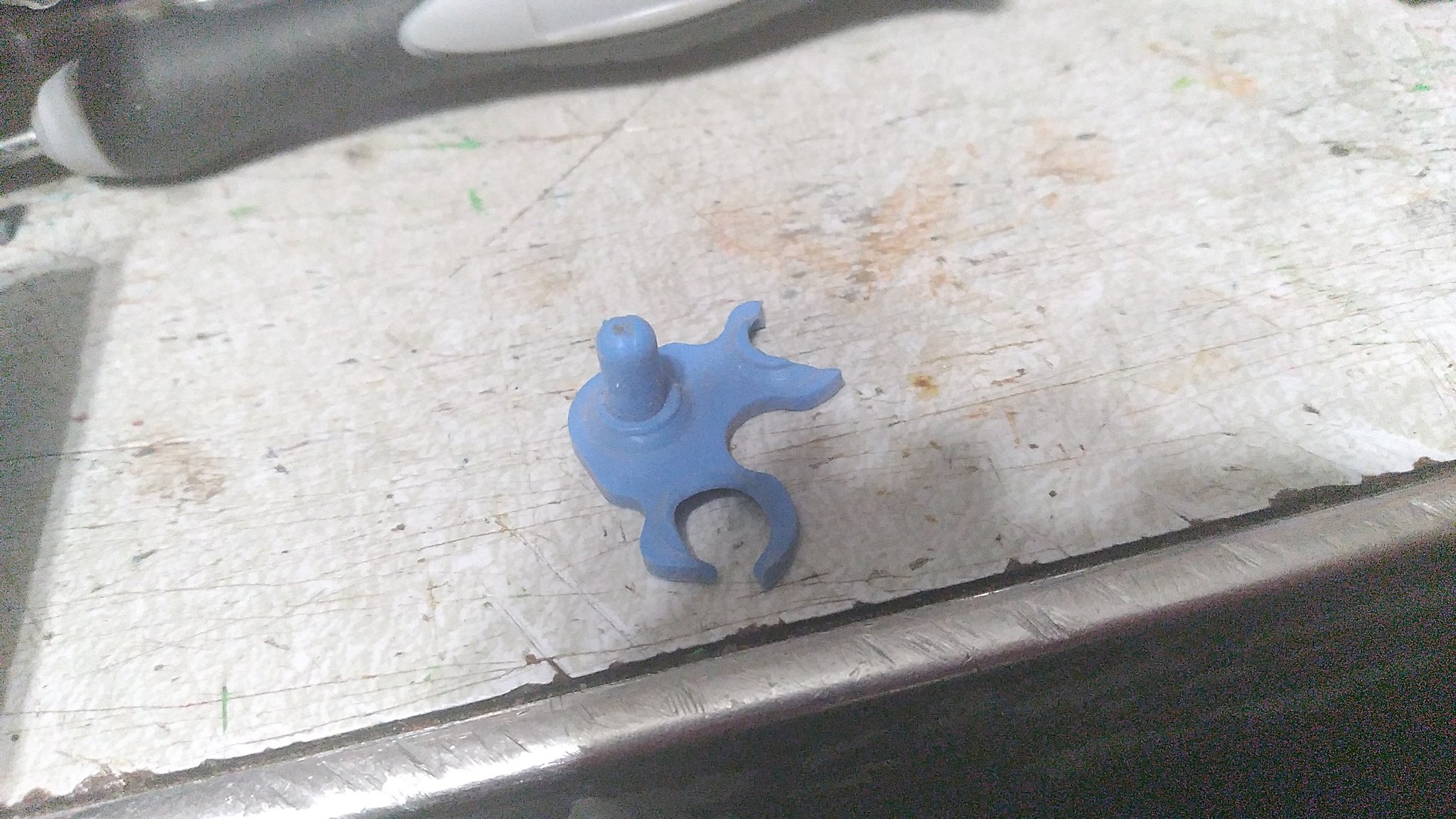

Seems my memory was playing tricks on me.... :blush: :facepalm: I just double-checked my MicroScout (which I popped the white top off of months ago to see if I could do anything about the buttons - I am aware that the silicone ones are a singular piece, by the way, and if you'll look closely have referred to them as such) and found the same thing. I could have sworn it had had microbuttons, but I guess my brain was mixing it up with Armada Optimus Prime's PCB. Oops. Looking at my buttons piece it's worse than I was remembering - two are torn completely off.
FWzi1RzVEAEVv3G?format=jpg&name=large
I had been hoping I could glue bits of other silicone (and, now that I know I need them, carbon pads) to what's left to act as replacements for what tore off. Or that enough other people would have run into this that somebody made reproduction ones.
Btw, the desire to fix over replacing isn't only motivated by cost - it's also motivated by a desire to avoid waste.
