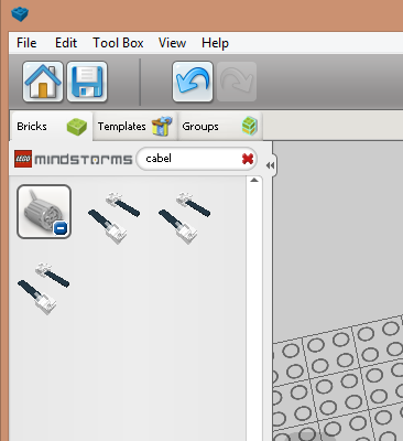

lustoro Posted January 26, 2020 Posted January 26, 2020 Hi, I'm new in LDD and tring to build Mindstorms robots in LDD. I've installed LDD 4.3 in Windows 8. I've taken cabel and tring to connect to ports of my robot, But I'm couldnt take edges of cabel separately and connect them to different ports. When I'm selecting one edge and tring to move that edge, second edge also moving with first edge.I'm assuming that sould work when I'm selecting one edge and tring to move, but in didn't work may be that is a defect or there is another way to take one edge of the cabel. Could someone please say me how I can take one edge of cabel(without taking both). Quote

lustoro Posted January 26, 2020 Author Posted January 26, 2020 (edited) Hi @NathanR, Thanks for your answer I've placed the cabel on the grid, and didn't connected them to anything, but after clicking one end of the cabel it takes both ends of cabel together. I've choosen cabels from the following list and cabels don't have colored triangles.(pls see attachments). Edited January 26, 2020 by lustoro Quote
NathanR Posted January 26, 2020 Posted January 26, 2020 @lustoro Huh, that is very odd. You should also have more than just three cable types returned by the search. Which version of LDD are you using? Is it 4.3.11? Quote
SylvainLS Posted January 26, 2020 Posted January 26, 2020 3 hours ago, NathanR said: You should also have more than just three cable types returned by the search. Confirmed. In Mindstorm mode and with the same typo we see in the screenshot (“cabel” instead of “cable”), there are 6 pairs of connectors available in 4.3.11: 11145 (250mm), 11146 (350mm), 11147 (500mm), and 55804 (0.2m), 55805 (0.35m), 55806 (0.5m). All with 60410 connectors. (Without the typo, still in Mindstorm mode, three other parts show and they are tuntables.) (For other connector types, you need to use the Extended mode.) So there’s undoubtedly a problem with LDD here. See the other posts about 4.3.12 / installing 4.3.11 on Windows 10, they have links to correct 4.3.11 installators. Now, about the coloured arrows, note they only appear if the part is placed, not when the cable’s still “held” with the mouse. But if you don’t see them (the colour changes with each new cable), then you really have a problem with your LDD. Quote
