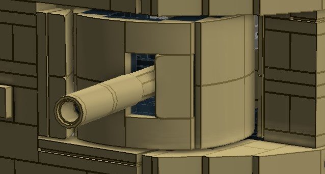

Tommy Styrvoky Posted August 20, 2018 Posted August 20, 2018 (edited) The sponson gun housing looks undersized, maybe something along the size of this would work better, though if you are mostly basing it off of @Sariel's model, I think that would help improve it more, as that appears to be under-scaled. Also with motorizing it, it shouldn't be too difficult, though I think it is possible to hide most of the electric stuff in the sponsons, As both m motors for operating the sponson guns could be fitted there, and maybe 3/5 of the XL motor too. If you want, I could look into that. As this would allow for a mostly full interior, minus the space needed for the Sbrick, IR, and LIPO. As you can see there would be plenty of space for more details in the interior. https://www.bricksafe.com/files/Tommy_styrvoky/Mk V sponson gun.lxf Edited August 20, 2018 by Tommy Styrvoky Quote

Stimy Posted August 20, 2018 Author Posted August 20, 2018 1 hour ago, Tommy Styrvoky said: The sponson gun housing looks undersized, maybe something along the size of this would work better, though if you are mostly basing it off of @Sariel's model, I think that would help improve it more, as that appears to be under-scaled. Also with motorizing it, it shouldn't be too difficult, though I think it is possible to hide most of the electric stuff in the sponsons, As both m motors for operating the sponson guns could be fitted there, and maybe 3/5 of the XL motor too. If you want, I could look into that. As this would allow for a mostly full interior, minus the space needed for the Sbrick, IR, and LIPO. As you can see there would be plenty of space for more details in the interior. https://www.bricksafe.com/files/Tommy_styrvoky/Mk V sponson gun.lxf Thanks a lot Tommy very kind of you to share these designs!! I saw that you were planning to build a MK V also? This design looks a lot more natural than the one I have now, didn't even think that far to use the roof tiles. For the motoring system I need to update myself as I am used to working with very old lego systems :P As for the interior, I want to make a full detail model but I think that the motor system will take up a lot of place for this? Or maybe I could make a false floor and hide it there? I want it to look like the reel steel version, so warhammer might not be perfect for this, but a good idea for future projects, thank for the advise Neonic! Quote
Tommy Styrvoky Posted August 20, 2018 Posted August 20, 2018 (edited) 16 minutes ago, Stimy said: Thanks a lot Tommy very kind of you to share these designs!! I saw that you were planning to build a MK V also? This design looks a lot more natural than the one I have now, didn't even think that far to use the roof tiles. For the motoring system I need to update myself as I am used to working with very old lego systems :P As for the interior, I want to make a full detail model but I think that the motor system will take up a lot of place for this? Or maybe I could make a false floor and hide it there? I may suggest looking into the Power Functions system, they offer more powerful and compact motors, for this project you will probably need 2 XL's to drive it, and 4 M motors to power the sponson guns, maybe one extra M motor if you want to have a fake engine. For controlling it, you have several options, you could use Lego's solution, and have 3 IR receivers, or use a 3rd party solution, and have much greater distance of control via 2 S bricks. Both systems have a similar cost for controlling 4 outputs, though the Sbrick offers a greater range, but it requires you to have a phone or tablet to control the model via bluetooth. Then for powering the model, one AA or rechargeable battery box would work, for the Sbricks you will need to get two extension cables to power them. Looking at the photo I posted above, you could hide the drive motors where the fuel tanks are in the rear, and all of the M motors could be hidden between the supporting walls for the suspension. The control system could be hidden in the rear of the fighting compartment, though In my design, I would utilize the Sbrick, as with the IR system, the top of the receiver needs to be exposed for the remote, this can make it more difficult, with the Sbrick you could hide it in the middle of the model. As for my project, with most things have planned are currently put on hold because of college. Basically from what I have said about the design of this model was my intentions for the project. Edited August 20, 2018 by Tommy Styrvoky Quote

Exile Phoenix Posted September 10, 2018 Posted September 10, 2018 If you're talking about the gaps between the walls and the sponson being too large, you could use the 1x1 with stud on the side to build out into the gap, and use some 1x2 cheese slopes to close it similar to this: Quote
Stimy Posted September 10, 2018 Author Posted September 10, 2018 10 hours ago, Exile Phoenix said: If you're talking about the gaps between the walls and the sponson being too large, you could use the 1x1 with stud on the side to build out into the gap, and use some 1x2 cheese slopes to close it similar to this: Hey Phoenix, This is a good idea, but i'll have to see if this doesn't obstruct the turret movement. the gaps that I meant were in the sponson design itself, because I am using the slopes on a 45° angle, this makes that there is a small gap between the slopes & the side of the sponson. Quote
Tommy Styrvoky Posted September 10, 2018 Posted September 10, 2018 3 hours ago, Stimy said: Hey Phoenix, This is a good idea, but i'll have to see if this doesn't obstruct the turret movement. the gaps that I meant were in the sponson design itself, because I am using the slopes on a 45° angle, this makes that there is a small gap between the slopes & the side of the sponson. Use 1x1 brick with headlight to inset the slopes by 1/2 a plate. Also for your choice of control, I would suggest getting a Sbrick, as it is cheaper, and it is more flexible with the ability to program via the profile designer. The only major advantage for the Buwizz is it offers a higher voltage output, and an integrated battery assembly. As with your model you will need at least 2 of whatever you choose to control your model with. Also the 8z gear you are using to drive the traverse gear won't work, you need a 12z and 20z both in half bevel and this part to brace them. Quote
