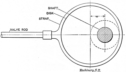

GeorgeCrecy Posted November 25, 2019 Author Posted November 25, 2019 (edited) 11 minutes ago, Jeroen Ottens said: Technic cam, part 6575 is that what you are looking for? In this case, I would be looking for something to replicate the image below: The necessity would be something that can connect up top to the valve rod, either using an axle or pin connection and from there I can use other means to get the off-position turning action working. However, if there was something that could work as intended for there to be a disc with a strap around it that can connect to something vertically, then all the better! As it stands, I would need to shave off a few millimeters from the train wheel I mentioned and chop off both ends of the cylinder with axle hole part to make it thin enough for my purposes. Again, I would preferably be looking for something no more than 2-3 plates wide to make it fit. Unfortunately for this the cam just doesn't work. Edited November 25, 2019 by GeorgeCrecy Quote
Aerolight Posted November 25, 2019 Posted November 25, 2019 The method I used was a pully wheel driven by one of the outer holes with a halve stud 1x2 technic piece, then to use a brick built square around it. Works amazingly well and is only 2 studs wide the only problem is that a 4x4 system square is slightly smaller than a technic so will only work with a technic square which may not add to the overall aesthetic. Are you planning to use glue? a lot of the pieces you have shown have large gaps (the radius pieces I only found out after a brick link order) and the sides of the other cylinders are even worse, not to continue the negativity but.. Lego engines rely on high flow of air and you just cant get that from a air bottle of reasonable size (even the best Lego engines struggle to run on compressors due to the lack of flow due to boost leaks). However there are ways around this just you will be sacrificing the aesthetic for functionality namely square pistons. I don't know if you've seen it but there's an even larger version on youtube driven by a motor (its huge like 10000 pieces +) and it looks great but if you want it to run on air a complete redesign is in order. If it helps I'm going to post my air engine after I get some more pieces to finalise it, but even now the engine has more power than a rc motor (albeit at a far higher rpm also a "small" amount bigger) so good engines are possible just requires restrictive methods i.e. they look low poly Quote

GeorgeCrecy Posted November 27, 2019 Author Posted November 27, 2019 (edited) Very nice Tommy! I'll see what I can come up with from here. On a different note, I am happy to report that I think I solved the eccentric issue, though it isn't as clean as I would like. It does use the pully wheel part, part 32126 with a 1/2 technic pin to join to the wheel, and on the opposite side are two 2 x .5 technic beams with technic axle 2 connecting one end. Given that there are two eccentrics right next to each other, I also had to figure out the connection system between the two. I am the worst person for this project given my complete inadequacy for anything mechanical, but below is my attempt at it, and it fits in the model pretty well! Such a problem might seem basic to others, but I'm a history major, and not at all competent in anything beyond theory. Further, the idea would be to glue the connector to the pulley wheel so that it doesn't shift around, and I included the universal connectors as there is some pretty sharp angling going on between these and the reversal links. The axles sticking out are IRL going to be filed down to be more flush. With these figured out, I have moved on to the rest of the needed items for the reciprocating engine. As mentioned above I have also at least some basics done on the turbine, including the rotor and its casing. Once its a little farther along Ill try and get some pictures up for folks. Any suggestions? Anything I'm missing or not figuring right? Please let me know! Edited November 27, 2019 by GeorgeCrecy Quote
