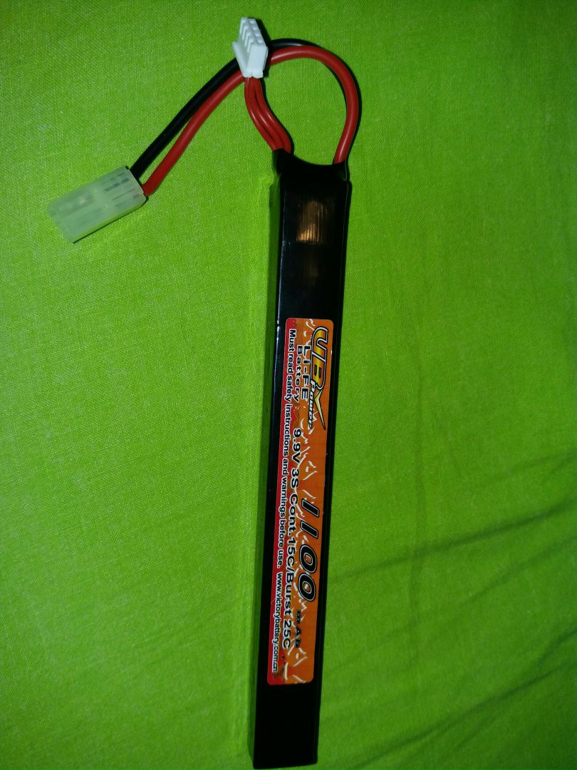

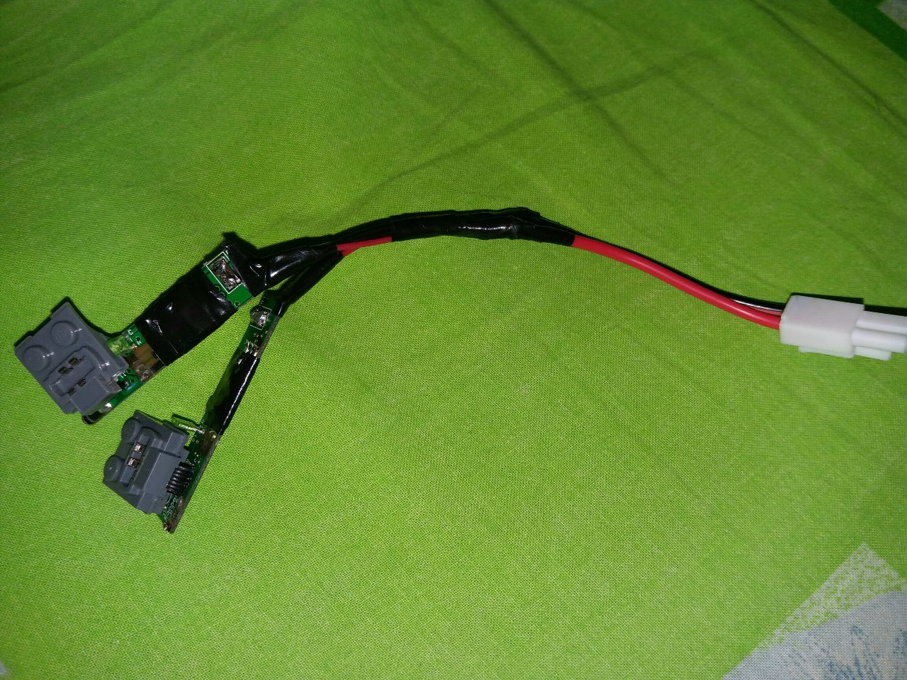

This is my favorite rock crawler because it is so fast! I have waited for someone to make a rock crawler that doesn't use a geared down XL motor:laugh: How did you connect the Li-Fe battery?
Oh, I think that's a good idea! With 9,9 volt battery xl motor should give enough torque and rpm for rock crawler
For connecting i use electrical plate from lego battery box with some modifications. :wink:
Argh! NOOO!! You beat me to it! I just bought two buggy motors for a planned fast crawler/buggy machine! :cry_sad:
:laugh: Hate to say because you did it before me, but excellent model! Love the responsive suspension, it works really well! Can you show in detail what you did to adapt the battery pack?

So..
i connect battery and sbrick,something like there:
red and black wires go to the electrical plate(from lego battery box 8881)with locked polyswitch.
white adapter goes to the battery.
