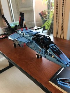

May I ask a question?  I am stuck on the fact that all of my functions seemed to work fine when I completed the model, except that, when switching from VTOL to Flight, the upper and lower fan doors don’t completely close, and I have not yet found the cause.  Any ideas?  Am I right in thinking that the pulleys that actually cause the doors to close (it seems that either the top or bottom one is actually pulled closed, and the other closing is triggered by the connection between the doors) are on the tail side of the transmission (gearbox), and I should look there to find the problem?  Any suggestions on debugging this problem would really be appreciated.  The top fan door stops at about 1.25 cm short of closing.  I’ve included a photo below.
Thank you for a great review!
Edited by Philosopher7
Added photo showing problem.
