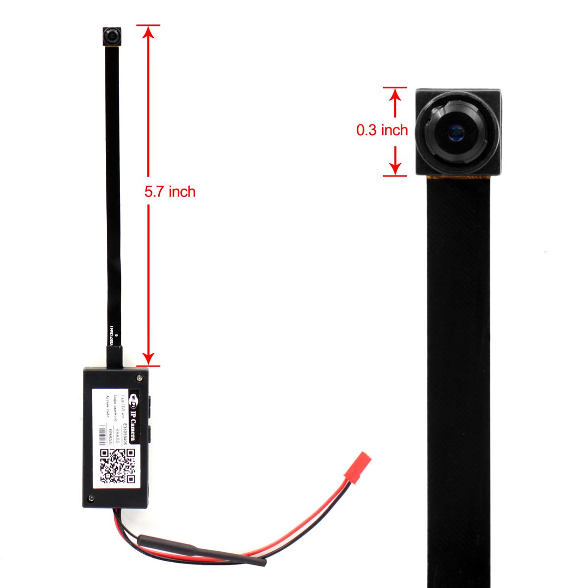

pirzyk Posted January 12, 2017 Posted January 12, 2017 (edited) I am looking for my 3rd camera. The first I picked up for $20 USD at the NMRA show in Indy. The size was great. Small enough to fit inside my CoNO engine. Instructions were in translated English from Chinese. When I got it to stream it was great (if only in SD) but it only lasted 5 min before it died. Charging seemed to be hit or miss. It sometimes worked again but not long enough. It looked similar to this one: https://images-na.ssl-images-amazon.com/images/I/61xl4mkxQPL._SL1200_.jpg Next was the Polaroid Wi-Fi camera. It does HD and lasts for about 90 min between charges. The problem is it takes 2+ days to recharge. At least the car I have it sitting on makes it look a bit like a tanker car. It has been suggested to make a deep sea sub out of it. I really want a micro/spy cam to build into an engine like legoman666 has and that does HD is reliable. I looked at the Freddi before I bought the Polaroid and decided against it because of all the reviews that showed it having reliability issues. Edited January 12, 2017 by pirzyk Added images Quote
