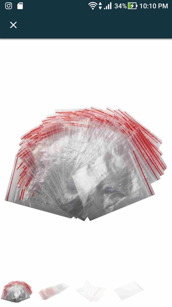

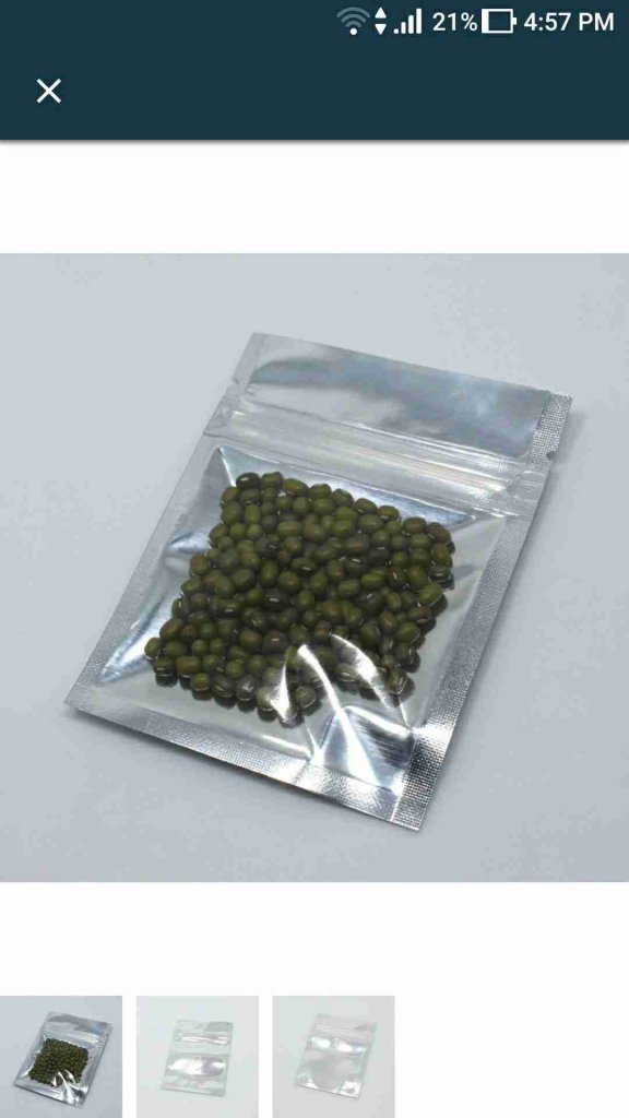

H..i i need your help guys.. Im a bit worried about storing minifigs in PE (polyethylene)zip bags.. And currently searching for PP (polypropylene) bags with zip in the net with no avail.. But i was able to searched for this an aluminum back and a PP clear plastic in front.. Would this be ok for the minifigure? I think aluminum doesn't corrode or rust in long term
Edited by emramada
Additional info
Aluminium technically does corrode, but the result is a tough layer of aluminium oxide that resists further corrosion. In principle it should be fine, you sometimes get lego sets in foil packs. However, I find that if I run my fingernail over a piece off aluminium, then it picks up a slightly sticky black deposit.  I'd be wary in cse the aluminium does affect your minifigures long-term.
I'm currently in the process of swapping all my parts over to low-density polyethylene bags (after using food freezer bags... this has been a disaster and left most of my lego bricks feeling sticky :cry_sad:).  They are supposed to be completely inert, and are used by museums, etc. for long-term archival storage.  I think either polyethylene or polypropylene would be safe - after all, new Lego sets have bricks in polypropylene, but they send out pick-a-brick/bricks and pieces orders in polyethylene re-sealable bags.
Hi NathanR thanks for the reply. Thanks also for giving me the heads up on the foil pack.. From what ive understood on your reply your your switching froom freezer grade zips to low density polyethylene zip bags? Is this safe for long term storage for minifigures?
Actually all my action figures (marvel universe) 7 years are in those freezer grade zip locks.. Im still looking for a viable replacement for these.. Im starting with my lego...
I saw these PE (polyethylene) food grade bags.. Will these be ok?
Edited by emramada
Yes.  LDPE is supposed to be inert, it doesn't react or break down so in theory it should be safe for minifigure storage.

Honestly, I've no idea. Anything designed for food storage isn't going to be good long term.  Supermarket food-freezer bags are typically made of an acidic plastic (possibly with a PVC component, which breaks down to release hydrochloric gas, that will attack whatever is in the bag.  Not such a problem for food being kept for a week or two, but for Lego...). There's an interesting article with recommendations here, but these are USA stores.  Personally, I've been ordering from here but I haven't had the bags long enough to know if they are any good.
