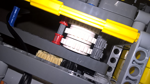

hjxbf Posted January 13, 2017 Posted January 13, 2017 On 17.10.2016 at 4:45 PM, quilkin said: A third in parallel (if there was room somehow) would extend the idea and make it safer than the fixed gear some people are trying. I did a quick mod that allows for 3 parallel clutches a few months back. To my recollection it was a matter of using longer axles for the clutches and follower gears, and omitting a structural bracing (3L liftarm) which the motor axle runs through. Works like a charm, with few unwanted stalls. See pic below and compare to BI Step 508. Quote
Gabi_BC Posted January 13, 2017 Posted January 13, 2017 I just replaced them altogether and don't regret nothing. Quote
