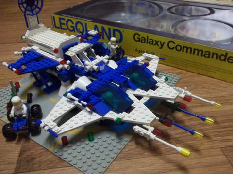

-Yesterday my son and I restored a 1983 Galaxy Commander that we found in Grandmas attic. It was in the original box with the original instructions!
As you stated the box says Denmark right on the side. Interestingly it also says, "Conforms to PS 72-76". I wonder if this has anything to do with cadmium?

uploaded pic of Galaxy Commander! Check it out!

There should be no possibility of any Cadmium in that set. Transparent LEGO parts are NOT made of ABS plastic. ABS in its' natural state is sort of a milky white color, so it is not suitable for trans colored parts. Trans-clear and all the trans colors are made of Polycarbonate, a different plastic.
From 1949-63 TLG used Cellulose Acetate plastic to make LEGO parts, including clear parts. But that was not possible with ABS plastic, hence the switch to Polycarbonate for trans colored parts.

If the sets have transparent parts, which I believe all of my old ones do, then does that mean the entire set is made of polycarbonate and not ABS? Or are only the tranparent parts made of polycarbonate? Hope you like the Galaxy Commander! We are only missing 5 original parts which we hope to find later!
J
No, only the Transparent parts are Polycarbonate... the rest are ABS plastic... but by 1980s.... all elements should be Cadmium free ABS. And since there are no yellow or red "non-transparent" parts to that set, you should be OK.
