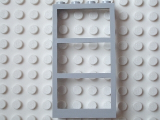

Large window molding marks (before 1985, 2007-2009)
This is not really a defect as such, but has been the subject of many complaints because the molding marks look like bullet holes. :grin: In recent times, this glass piece has had a large blob-like mark on it, while smaller windows have four, small dots in the middle and/or faint circular marks along the edges. As of summer 2009, the first window seems to have been fixed, although some currently sold sets still include the older windows.

Large window molding marks, as seen here
This is not a quality control issue. These mark is an injection point, where the plastic is fed into the mold. They occured because the first 1x4x6 window panes were intended for this frame 6160.jpg
This frame disguised the large molding mark that exists a third of the way up (or down) the pane.
When Cafe Corner came out, and introduced this frame...
... the same piece was used for the pane, and created the problem of the "bullet" hole look.
Just this year, LEGO introduced a new window pane mold to address this issue. It has not been cataloged on bricklink, but it is available on PAB online. The mold injection points smaller and located in much less visible locations.
This is not a quality control issue. These marks are injection points, where the plastic is fed into the mold. They occured because the first 1x4x6 window panes were intended for this frame
Yes, that issue is something of an outlier, but there are a couple of reasons why I think it's still worth a mention there:
1: This concerns not only that piece, but also others like this and this which have several, smaller dots on them.
2: There have been many complaints about this on EB in a quality context. There is at least a perception of a problem here, even if those marks are supposed to look like that. The issue is not the presence of marks (which exist on any piece), but the fact that they are big/numerous.
3: As you said, the issue is being fixed. The big glass pieces in recent sets no longer have the big mark on them. I don't know if this applies to the smaller glass though.
4: The molding marks on similar types of separable window glass in past, like this and this, were much less prominent.

I didn't mean to imply that it shouldn't be included here. It's an issue that comes up frequently and should be addressed. I just wanted folks to know the "why" of this window, which is the one that is most frequently discussed and I think (I could be wrong) is the only one with the large centrally located blob.
Ah okay. Thanks for the explanation then. :classic:
I think that is indeed the only one with the big blob, aside from the early 1980s windows. The others have different kinds of marks. I will update that description a bit and elaborate on this.
